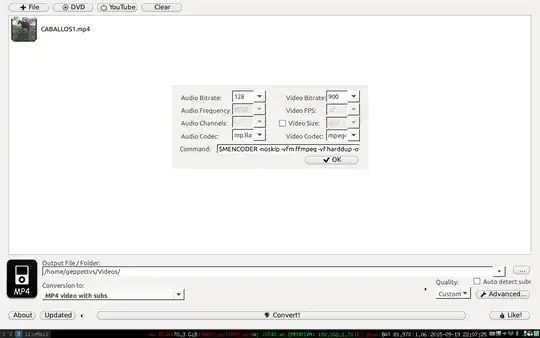

When it is about muxing/remuxing/transcoding the very best GUI Tool for ffmpeg/avconv/mencoder seems to be the Mobile Media Converter by Miksoft (https://www.miksoft.net/mobileMediaConverter.php) of which I am going to illustrate as follows:
MMC will also allow you to rip from DVD and Download from YouTube.
