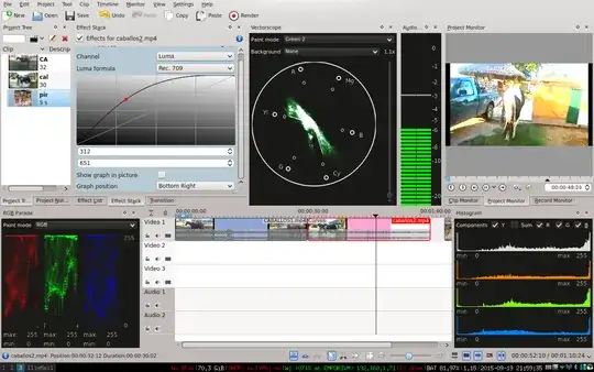

My favorite is kdenlive so I am going to place this screenshots over here in order to illustrate the timeline video placement:
In this timeline I am using 2 Video sources and 1 picture. 1 of the videos is having the "Curves" plugin and I am adjusting brightness level with that plugin. As you can see, kdenlive provides several tools for audio/video levels monitoring so that you can achieve professional results from your production.
