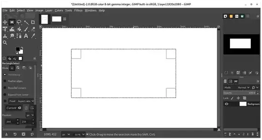

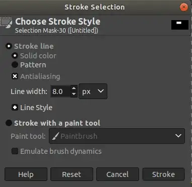

Select the area you would like to outline with the rectangle select tool. enter image description here

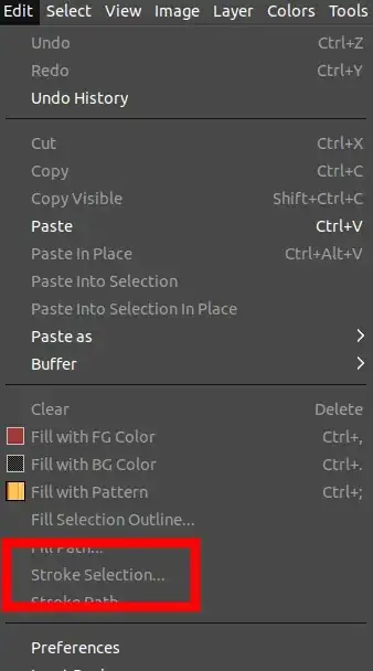

go to Edit > Stroke Selection.
You will get a dialogue. Choosing Solid Line will create an outline using the currently selected foreground color. Choosing Stroke with a Paint Tool will give you more creativity.

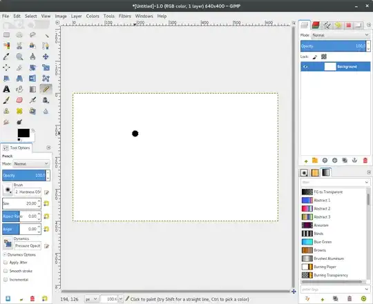

I have a simple solution:

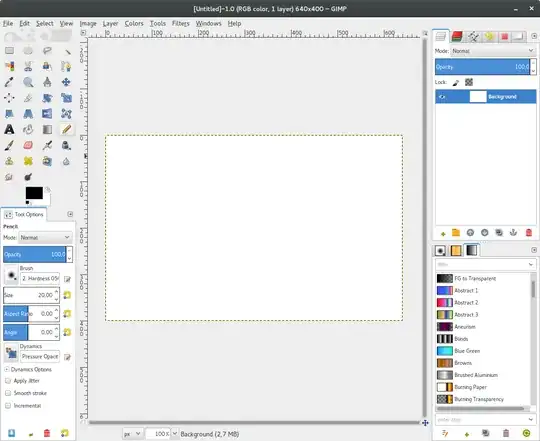

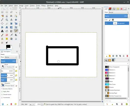

  1. Select the Pencil tool
  2. Click on your image
  3. Press Shift and hold and press Ctrl and hold for the steps below
  4. Move your mouse and click
  5. Move and click again to complete your rectangle

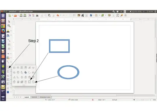

A GIMP Alternate:
A simple tool for drawing rectangles and ellipses on pictures is already included in Ubuntu
LibreOffice:Draw
  1. Open the image in LibreOffice Draw. You can do this by first opening Draw and then opening the image in it. Or you can right click on the image and choose Open with > Other Applications > Show other applications.
  2. Look for Basic Shapes in the left hand tool bar and click the down arrow next to it. See Step 2 in the picture below:
  1. Select Frame or Ring shape. You can reduce the width of the ring and squish to to an ellipse if you want.
Hope this helps

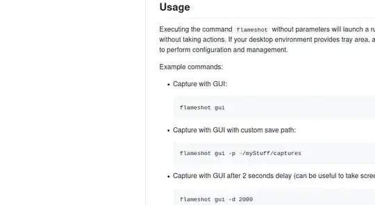

A different tool that I use a lot for this purpose is Flameshot. It is very handy when you want to take a screenshot of something, then mark, annotate, blur, point to stuff, etc.
Flameshot
Basically, we use Right-Click to pick colors, and Ctrl+Mouse_Wheel to increase and decrease stroke width. See README on the repo for more detailed info.
https://github.com/flameshot-org
