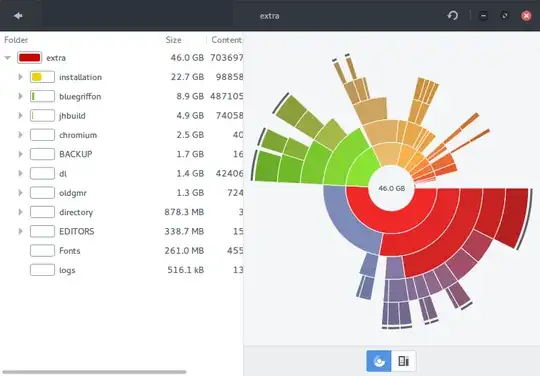

If you want a GUI application to do that, you can use Disk Usage Analyzer (or baobab), to check:

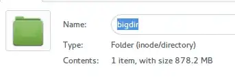

Or use the 'Properties' feature (in most file managers):
The last one I think caches a bit unless a noticeable change occurs (in Nemo anyway).
