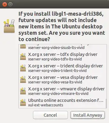

Edit: removing the ppa has no effect. It would seem that the problem is with libgl1-mesa-dri:i386 If you try to install it with apt-get you get errors about unity-control-center that are above. Synaptic will not even find the them and if you try with the Software Center you get a warning:

I solved the problem using Synaptic and installing steam:i386 not steam-launcher (that Synaptic does not find)
Edit by the question OP to add an explanation and more info
Using the commands in the answer above the Steam install went fine but it has some quirks:
1st some background: I initially installed Steam with the Software Center's "Reinstall previous purchases function. This installed steam-launcher Which as the answer above states cannot be found by Synaptic. This is because Synaptic only finds programs that are already in the repos but Steam launcher is in it own ppa. The Software Center can see "for purchase" applications, which is what Steam initially was released as. "For purchase" here does not necessarily mean that you have to spend money, what this function does is allow you to install apps that are only available in their own ppa. Installing this was add the ppa as well as the program.
For some reason installing in the above manner does not pull in the libs from the vivid stack only the original trusty repos and the trusty-updates repos. This causes the conflicts and the dependency errors that I posted in my question. Installing per this answer corrects this issue and pulls from vivid.
There appear to be several ways to get the steam:i386 one is using Synaptic. The other graphical way is the Software Center but you have to click on the bottom left of the window to "Show [a number of] technical items" In my tests this also brings up the steam:i386 option.
That last way is using the terminal and typing sudo apt-get install steam:i386 (note that here for some reason using the Tab button to auto-complete doesn't work here you have to type the whole steam:i386 out.
Using the terminal to do a simulation I saw that it would install the libs from the vivid repos and that I got no errors. I went ahead and installed.
If you check via Synaptic you will see that it pulls in a newer version of Steam than steam-launcher installs, it also installs slightly differently. These differences lead to the quirks I mentioned above.
