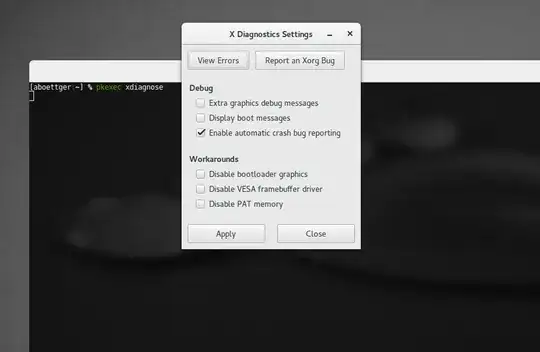

Either you have changed your desktop file /usr/share/applications/xdiagnose.desktop or you have an additionally desktop file in ~/.local/share/applications
The originally content looks like this. Note the line Exec=
[Desktop Entry]
Name=xdiagnose
GenericName=Diagnose Graphics Issues
Comment=X.org Diagnostic and Repair Utility
Exec=pkexec xdiagnose
Icon=/usr/share/xdiagnose/icons/microscope.svg
Terminal=false
Type=Application
Categories=System;Settings;
X-Ubuntu-Gettext-Domain=xdiagnose
Use pkexec xdiagnose instead of xdiagnose, also in a terminal.
Ok, the problem seems not to be solved in that way, therefore a shot in the blue.
Reinstall the package again via
sudo apt-get install --reinstall xdiagnose
If that not help and as pkexec xdiagnose works in a terminal, create a bug report for GNOME shell:
ubuntu-bug xdiagnose
