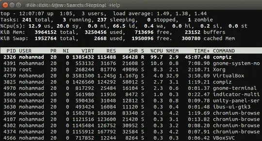

The system fan was working hard and the CPU load showed that a process is fully consuming one of the cores, so I checked it out via top and strangely I'm seeing two instaces of compiz which one of them is chocking the system!
top-list
