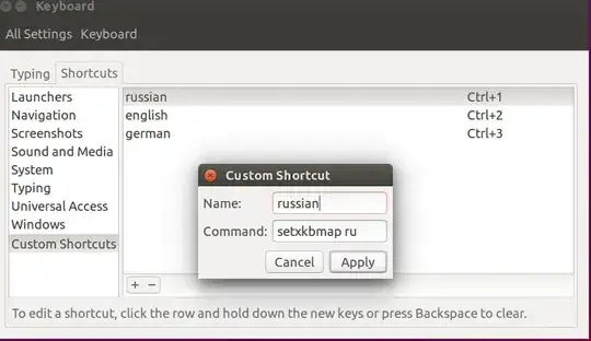

You can do this using setxkbmap. From man setxkbmap:
The setxkbmap command maps the keyboard to use the layout determined by the options specified on the command line.
To do this, open Keyboard from settings and click on Custom Shortcuts. Click on the + sign and add fill up the 'Custom Shortcut' windows as shown below:
Press Apply. Click on 'Disabled' and press Ctrl + 2 to make this as a shortcut for enabling Russian.
Now repeat the steps, but add setxkbmap us as the command and Ctrl + 1 as the shortcut. This will enable Ctrl + 1 as the shortcut for English

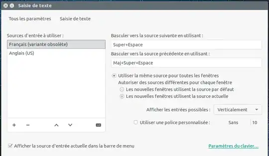

You can quickly switch between your installed keyboard layout by pressing Super + space bar.
For changing this keyboard shortcut go in :
System settings > Text Entry.
enter image description here (sorry screenshot not in English)
