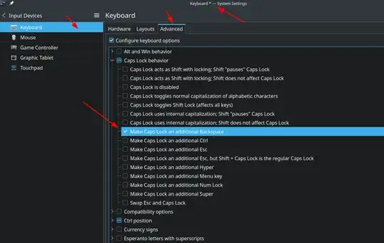

In Gnome, KDE, Mate etc keyboard advanced settings there should be an option for that. For example, in Plasma:
