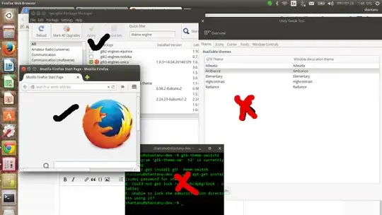

I was trying to install ubuntu-desktop package in Ubuntu-Gnome(gnome shell). Using unity-tweak I set theme as Ambiance. But only gtk2 applications are looking good. All gtk3 application has ugly border(header bar) and background(sometimes). I have attached a screenshot.
What is the default gtk3-theme-engine in Ubuntu unity?
Edit
if I run gtk3 application with root permission then theme is okay. I also created a new user but result is same. enter image description here

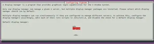

If you want to use GTK, first change your display manager. Perform following operations.
sudo apt-get install gdm
sudo dpkg-reconfigure lightdm
You will get a screen like this...enter image description here
choose "gdm" using your cursor and then press enter.
Then you can restart the machine (optional), or just log out and login to "gnome-shell"

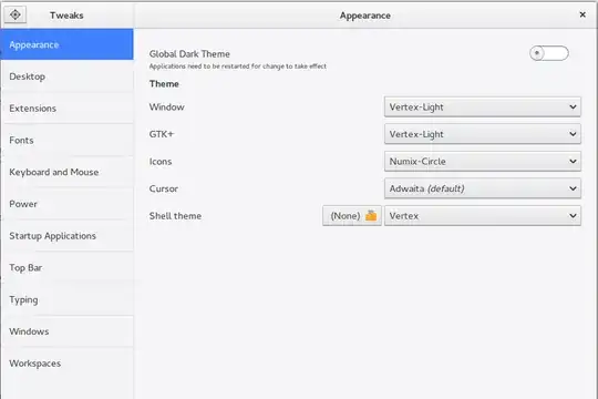

Therafter you can use "tweak-tool"
sudo apt-get install gnome-tweak-tool
Open the tweak-tool. Here you can choose whatever theme you may like, but make sure "Window" & "GTK+" has the same theme, else you will get the issue as you mentioned, that the window headers will be different.
I personally like Vertex theme. Try it out.. its quite brilliant,especially the dark one. enter image description here
