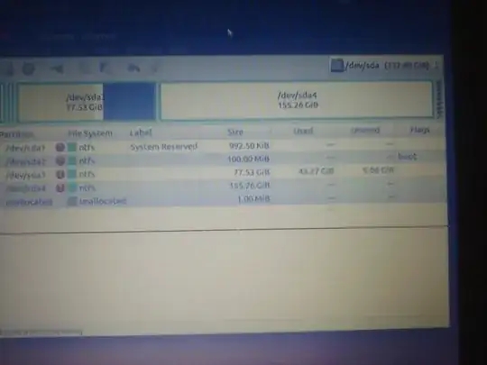

Now I want to install ubuntu on another partition. I tried creating 30GB unallocated partiton, using disk manager on windows 7. Now when I enter Installation, there are always 3 options - Install ubuntu inside windows7 , erase all data on disk and install, and the last something else. So I selected something else. There after when I reached at partitioning screen, there are only 2 partitions detected, 83GB NTFS which is my C: and another 166GB which is the summation of E: & D:. As you can see I have 77GB C: then also it is showsing 83GB. But thats not the issue, issue is where is that 30GB unallocated partition?
Also there is no option to install ubuntu alongside win7. And I don't know actually that what the option "install ubuntu inside windows 7" will do.
This the screen which appears after select "Something else" option.
