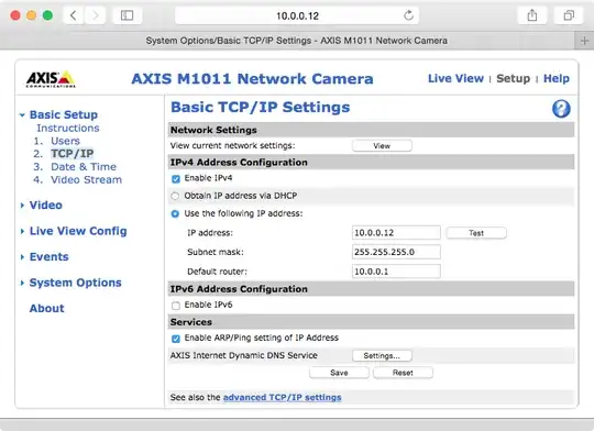

This network sort of works when "Computer" is running OS X; I can access "Network camera" (an Axis M1011) at its default address 192.168.0.90 and set a new IP address (e.g. 10.0.0.12) through the camera's browser interface only when Wi-Fi is turned off. I can also view the camera's video feed, etc. When Wi-Fi is turned on, I cannot reach "Network camera" at the address I set. (This at least confirms that everything on the switch is working, and that I can configure "Network camera" if need be.)
axis-camera-settings

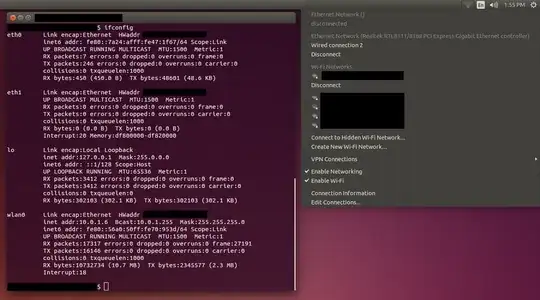

Here is the output of ifconfig after setting everything up as pictured:
ifconfig

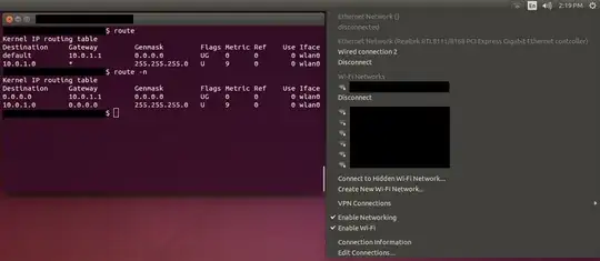

An here is the output of route and route -n:
route
I've tried the following link:
However, it seems that I have to solve the problem of getting Ubuntu to actually connect through "Switch" first, since it isn't even showing up in route and Ubuntu disconnects from "Wired connection 2" after a short time (and periodically tries to reconnect).

(Everything works acceptably now, but if anyone could explain in the comments the Default router field in the Axis camera TCP/IP browser settings (see the second image in the question text) or the DNS servers field under the IPv4 Settings tab when creating a manual Ethernet connection I'd be grateful. I'm not sure what role those addresses play.)
