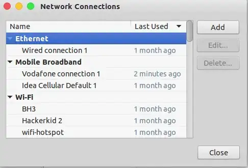

So, firstly search for Network Connections in the unity dash. Then, under the Ethernet section, click 'Add' button.

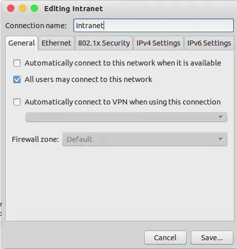

Then, we need to create a new Ethernet connection which we are going to enable manually. Uncheck the option of connecting automatically since this is your Intranet connection.

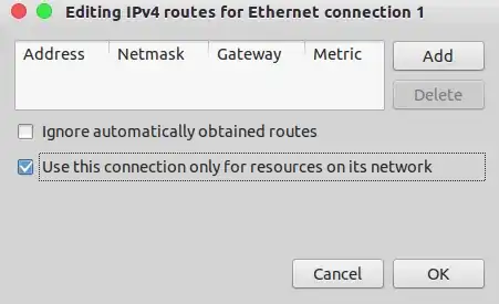

Then go to the IPv4/IPv6 settings (depending on your network) and then click on the Routes button. Check the 'Use this connection only for resources on its network' option. Click Save.
Now you can use both the LAN and WiFi simultaneously.

  • Launch Network Connections, e.g. by clicking on the network icon at the upper right and choosing "Edit Connections..."
  • Select the "Wired connection #" corresponding to the Ethernet port that will be connected to the switch. Choose "Edit..."
