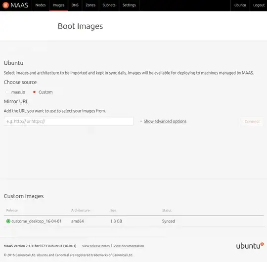

YOUR_CUSOMIZED_ISO_NAME is a label name that will show on your MAAS dashboard when you selects which image you want to deploy. In my case, it is custome_desktop_16-04-01. You can see that there is a customized image which is syncing in the following MAAS dashboard screenshot.
Syncing to rack controllers
Wait for few minutes until it is synced.
Now you can deploy this customized desktop image as usual. Select the tab Custom and your customized desktop image name like this:
