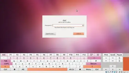

Gnome.org gives details of how to enable the embedded keyboard for a locked screen including the gsettings values
Any tablet-type screen keyboard must compy with the XEmbed specification.
Fortunately the standard onboard keyboard is XEmbed compliant - you need to pass the --xid parameter (type onboard --help for parameters you can pass to onboard)
Thus
gsettings set org.gnome.desktop.screensaver embedded-keyboard-enabled true
gsettings set org.gnome.desktop.screensaver embedded-keyboard-command "onboard --xid"
