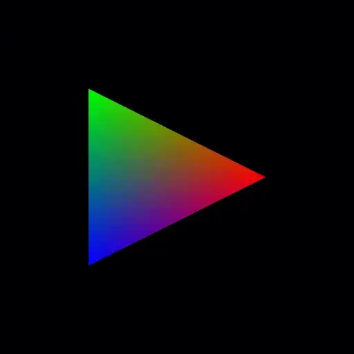

wget -O opengl-rotating-triangle.mp4 https://github.com/cirosantilli/media/blob/master/opengl-rotating-triangle.mp4?raw=true
ffmpeg \
-i opengl-rotating-triangle.mp4 \
-r 15 \
-vf scale=512:-1 \
-ss 00:00:03 -to 00:00:06 \
Image info: 426kB, 45 frames, 512x512 apparent size, coalesced, conversion time on a Lenovo P51: 0.5s.
The above conversion also worked after a ulimit -Sv 1000000 (DRAM usage limited to 1GB), so it does "not consume huge amounts of memory" like previous attempts I did with Imagemagick which almost killed my machine. 500MB however failed because ffmpeg failed to load its shared libraries... time to upgrade your RAM ;-)?
Test data generation procedure described on this post.
The output has a visible dotting pattern, which is not as visible in "ffmpeg + convert" method below. We can try to improve the image quality with methods described at:
- https://superuser.com/questions/556029/how-do-i-convert-a-video-to-gif-using-ffmpeg-with-reasonable-quality
- https://stackoverflow.com/questions/42980663/ffmpeg-high-quality-animated-gif
E.g. using the palettegen filter:
ffmpeg \
-r 15 \
-vf "scale=512:-1,split[s0][s1];[s0]palettegen[p];[s1][p]paletteuse" \
Image info: 979K, 45 frames, 512x512 apparent size, coalesced, conversion time on a Lenovo P51: 3.5s.
So we see that:
- the dotting pattern is much less visible now
- GIF size roughly doubled. TODO: why does simply choosing a palette increase the image size? Is it because now more colors so we need more bits per color? How to observe each palette?
- generation time was 7x slower, presumably because ffmpeg is first scanning through the entire video to determine an optimal palette
We could also play with documented palettegen parameters like palettegen=max_colors=16 to achieve different size quality trade-off points.

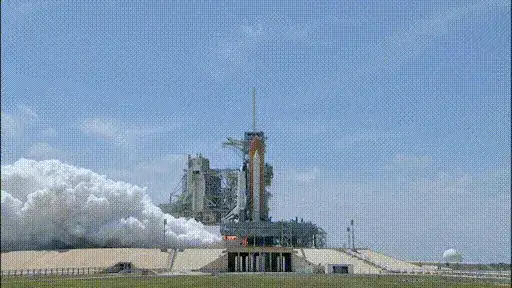

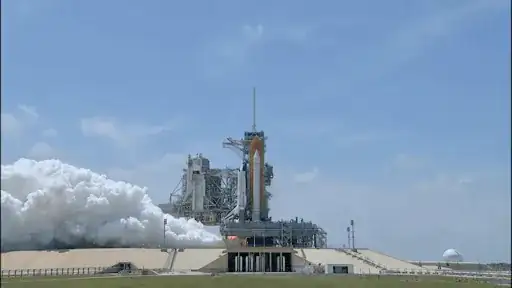

Video camera footage example
If you want to see the result quality of a video camera video from Wikimedia Commons with a similar command:
wget https://upload.wikimedia.org/wikipedia/commons/f/f9/STS-132_Liftoff_Space_Shuttle_Atlantis.ogv
ffmpeg -i STS-132_Liftoff_Space_Shuttle_Atlantis.ogv -r 15 -vf scale=512:-1 \
-ss 00:00:17 -to 00:00:22 STS-132_Liftoff_Space_Shuttle_Atlantis.gif
Image info: 1.3MB, 75 frames, 512x288 apparent size, coalesced (has minimal effect however, because footage pans slightly from the start), conversion time on a Lenovo P51: 2.3s.
Here is a version with palettegen but only 2 seconds to fit the 2MiB upload limit:
Image info: 1.5MB, 30 frames, 512x288 apparent size, conversion time on a Lenovo P51: 43s.
