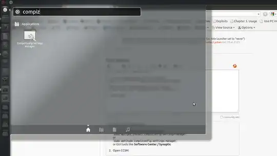

  2. Open CCSM with dash menu (Press SUPER to open Dash):

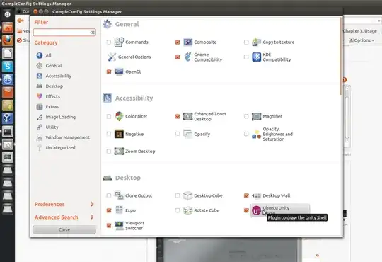

enter image description here 3. Select UNITY plugin:

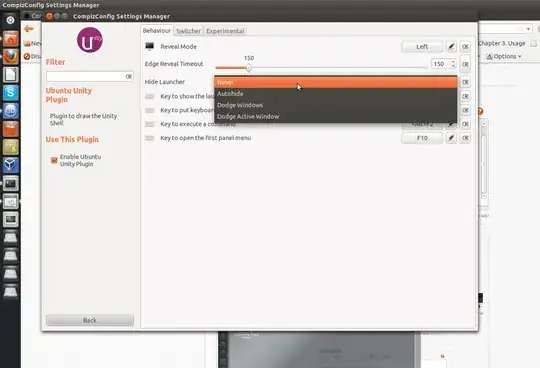

enter image description here 4. DISABLE AUTO-HIDE
Now you HAVE TO log out or reboot the computer for this to work. Same goes when changing the icon size in the launcher. It does not take effect the first time you change it. Only after rebooting will it work. At least for me.
NOTE - Stopping the Auto-Hide will save some trouble with some windows like the Back Button of Firefox been underneath the Launcher when it "auto-appears". It is VERY IMPORTANT you update the system (Check for updates with the Update Manager and apply all of them). Reboot and then do this answer. This way you save yourself some other troubles that have been fixed already with this minor updates.
As you can see in all the images the Launcher stays there in a fixed position. Saving me some seconds each time I need to search for something.
