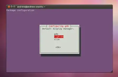

You'll get a screen that look like this:
choose the one you want(kdm) and hit enter, then probably you need to make a reboot.
