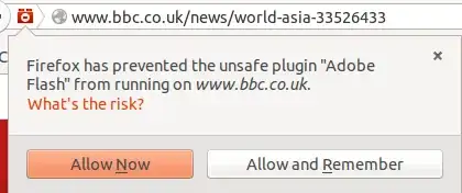

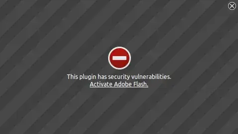

There is now no way to make it always active without some prompting, but you should be able to allow Flash for individual content by pressing the Activate Adobe Flash:
Or you can enable it for the site, and even choose to remember that you want it active for that site:
