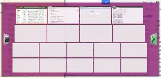

The visual switcher is very poor at providing context. E.g. the browser window thumbnails are too small to tell apart, and often most of them are blank (see screenshot). Unity switcher with useless thumbnails

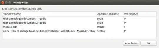

  1. list the windows, sorted by window name:
    Run with the command:
    python3 <script> -win
    type the first character(s) of the sought window and press return to bring the window to front.

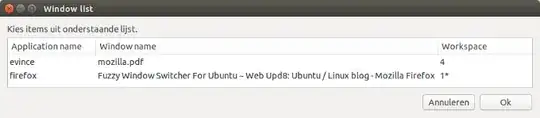

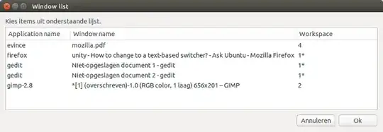

  2. list the windows, sorted by application:
    python3 <script> -app

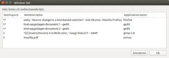

  3. list the windows, sorted by workspace:
    python3 <script> -ws
As you can see, the displayed columns are: Window name, Application, Workspace. The pre- set sorted column is always the first one.

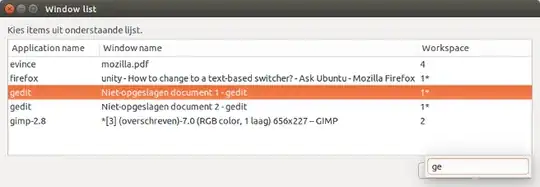

Fuzzy?

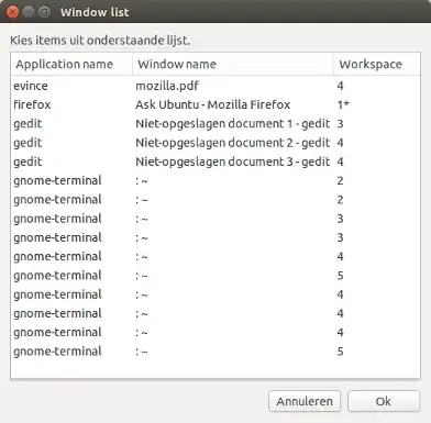

To select an item from the list, simply type the first character. If there are more items that meet the typed character(s) the arrow keys will only browse through the items that meet the typed characters:
Furthermore:
