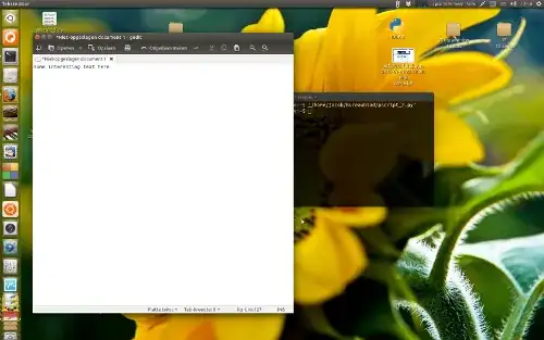

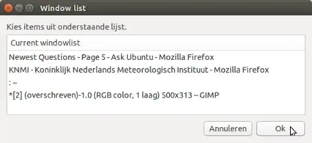

List windows, choose one to move to the current workspace
When the script below is called, it will list all windows on all workspaces. Pick one and press OK to move the window to the current workspace and raise it. By default, it moves the window to position 100 (x), 100 (y)
The script is relatively simple as a result of the use of both wmctrl and xdotool. While wmctrl is used to list all windows, xdotool simply moves them to a predefined position on the current workspace "without asking questions" on the window's size (unlike wmctrl) and relative positions of both workspaces to each other.
A more precise positioning of the window, according to the position on its original workspace, would very well be possible, but would also multiply the needed code (like e.g. here). I assume in most situations, this will do.
An example:

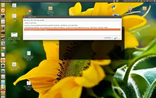

I am on workspace 8, while I have a gedit window on workspace 1. Calling the script lists the windows:
picking the gedit window will move it to the current workspace:

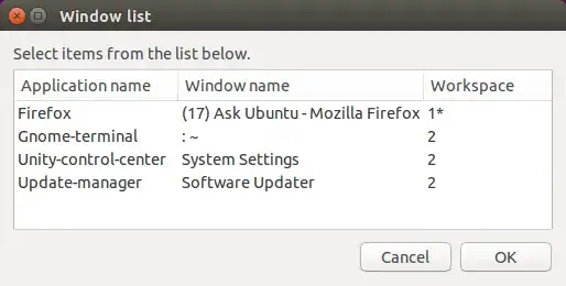

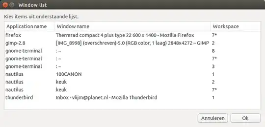

As requested in a comment, below a version in which the zenity list- window includes more information: de current workspace of the targeted window(s) and the application it belongs to.
As mentioned above, the information on the relative/absolute workspace positions leads to a more "substantial" amount of code, but luckily I could use this earlier answer as a base.
How to use
The use is pretty much the same as the first version of the script (above), but the command needs to include the preferred sorting option. Run it by one of the commands:
python3 /path/to/move_windows.py -app
to sort the list by application,
python3 /path/to/move_windows.py -ws
to sort the list by workspace, and
python3 /path/to/move_windows.py -win
to sort the list by window name.
