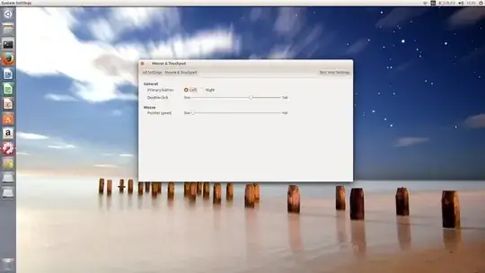

I have a problem with my touchpad; I can't scroll down with 2 fingers and I don't know why. I have searched on Google about my problem and I've found some answers but none of them don't work for me. One solution I found was to go in System Settings -> Mouse & Touchpad -> Touchpad and check the Two-finger scrolling, but I don't have that option.
Touchpad Settings

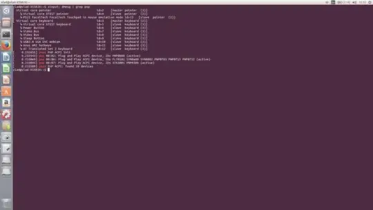

Output of "xinput; dmesg | grep pnp"

You have a Focaltech touchpad. The driver can be installed by running in terminal
sudo add-apt-repository ppa:hanipouspilot/focaltech-dkms
sudo apt-get update
sudo apt-get install focaltech-dkms
You can run
 sudo modprobe -r psmouse
 sudo modprobe psmouse
to get it work immediately, or just reboot.
If you have 14.04, then you will have to reboot, because new kernel will be installed.
