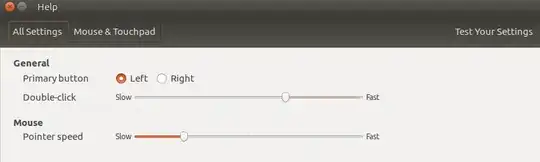

Well I tried on "mouse and touchpad" but there isn't any option to disable tap to click:

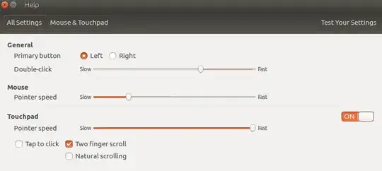

Restarting pmouse solved my problem (as suggested by @Pilot6 ):
On terminal:
sudo modprobe -r psmouse
sudo modprobe psmouse
Then the touchpad options will appear on "mouse and touchpad"
