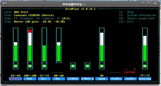

  1. Open the terminal and type alsamixer:
    Using the ARROWS lower the PCM Bar while listening to the buzzing sound. Start lowering the rest of the bars to see which one starts changing the buzzing sound. If you find that one of the bars starts lowering the buzzing sound you have found the problem. If not let's continue.

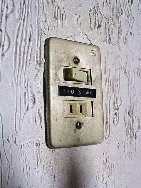

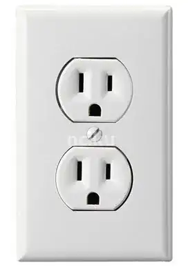

    NOTE: If you DO NOT hear a buzzing sound after unplugging the power cable from the laptop then you have a grounding problem. Remember this:
    This is the correct grounding socket:
    This is the wrong ugly NOT grounding socket (more like sewer water socket):
    So remember kids, connecting your PC to a NON-Grounding Socket is giving the PC Aids. Wear a condom, give it a GROUNDING SOCKET!... and plant a tree..for dogs.
    MORE INFO - http://en.wikipedia.org/wiki/AC_power_plugs_and_sockets
