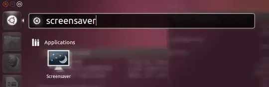

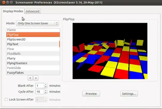

Now start the xscreensaver configuration tool - from a terminal:
xscreensaver-demo
or search from the Dash:
Click OK to both prompts asking to turn-off Gnome Daemon and to start xscreensaver-daemon respectively.

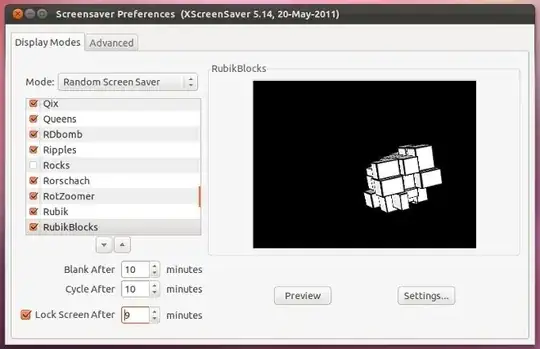

Ubuntu 11.10 doesn’t come with screensaver package installed. You must install xscreensaver if you want screensavers activated when your computer becomes idled.
  1. sudo apt-get remove gnome-screensaver
  2. sudo apt-get install xscreensaver xscreensaver-gl-extra xscreensaver-data-extra enter image description here
