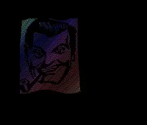

This runs the screen-saver in a window:
bob

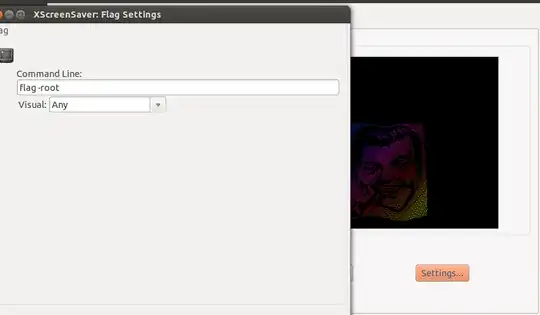

Integrating with xsceensaver:
  1. Copy flag to /usr/lib/xscreensaver (may need sudo permission)
  2. run xscreensaver or xscreensaver-demo
  3. Select any existing screensaver go to → Settings... → In the command line change to flag -root
Settings
