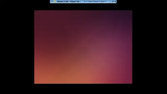

I recently installed Ubuntu 14.4 on my VMware. (It opens in command line. Using startx enters me into GUI mode.)
Problem: I cannot see side panels and menu bar:
Unity not appearing
I took the following steps so far:
Is there anything more required?
Mr.X
  • 207
The problem was with easy installation of VMware. I built a new Virtual machine (without allowing VMware to install the OS on it's own) and installed the OS manually. After that adjusted the resolution.
Now there is no display issue.
