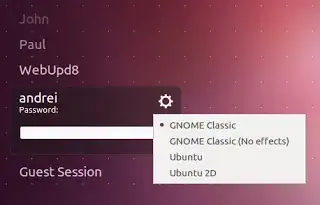

Install the APT Task ubuntu-desktop. Run
sudo apt-get install ubuntu-desktop^
(The caret at the end is not a typo.)
Then at the login screen you should be able to select the Unity session rather than XFCE, like this:
