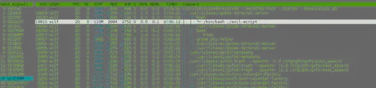

Usually you can use top, htop or similar to find the process and and kill it (or if you know the name or PID of the process, you can killall, pkill etc). For example, using top, I can select a script running from terminal and kill it by pressing k+Enter:
If that does not work, k+9+Enter should use the SIGKILL signal. SIGKILL requests that the process be killed immediately, and doesn't wait for the process to finish cleaning up resources etc like SIGTERM does. Ctrl+C a process only sends SIGINT to interrupt the process, like SIGTERM does.
Using the the tree view (press t) in htop also eans you can determine the parent processes of a script, and kill those to make sure it does not carry on looping.
