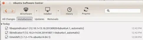

Edit: I reinstalled Ubuntu and looked for all the changes, the 3g mobile broadband usb stopped working sharply after the libindicator and libappindicator were installed (automatically by ubuntu). Here is the screenshot
