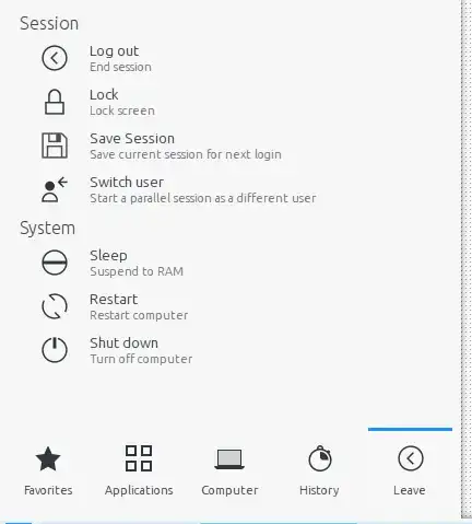

Then there will be an entry in the "Leave" section of the standard Plasma launcher widget, called "Save session".
Launcher menu
