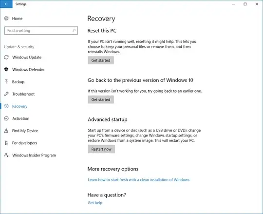

  • There should be no problems on default Windows 10 installations (UEFI).
    I just had to reset one of my Windows 10 installations due to a Windows update error (which I could fix this way) and none of the Grub installations (one SSD with Ubuntu; one HDD with Windows 10, Ubuntu and Fedora) were touched.
  • Method used: Settings → Recovery → Reset this PC → Keep my files
