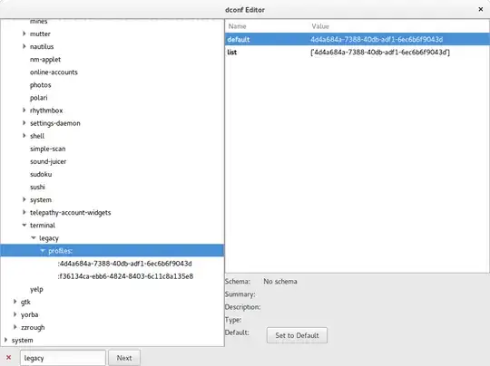

I have the following entries in my dconf-database. The entries are gnome-terminal profiles.
% dconf dump / | grep legacy
[org/gnome/terminal/legacy]
[org/gnome/terminal/legacy/profiles:]
[org/gnome/terminal/legacy/profiles:/:4d4a684a-7388-40db-adf1-6ec6b6f9043d]
[org/gnome/terminal/legacy/profiles:/:f36134ca-ebb6-4824-8403-6c11c8a135e8]
The same schema in the dconf-editor.
The entry :f36134ca-… was a terminal profile, but the profile does not exist anymore in the profile list in gnome-terminal . How can I remove the useless entry/profile?

Take the entry f36134ca-ebb6-4824-8403-6c11c8a135e8 from the output of
and add it again to the values of the key with the name list.
Now open gnome-terminal and remove the profile.
