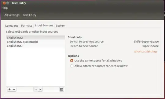

If using an external keyboard plugged to the mac laptop, you can also map the keyboard in the list of available inputs in your Ubuntu instance by defining it in Settings -> Text Entry -> Input Sources as shown below (for a UK laptop). After that, you can switch between keyboards with the top-left corner icon (if on Metacity), e.g. En1:
Keyboard setup
