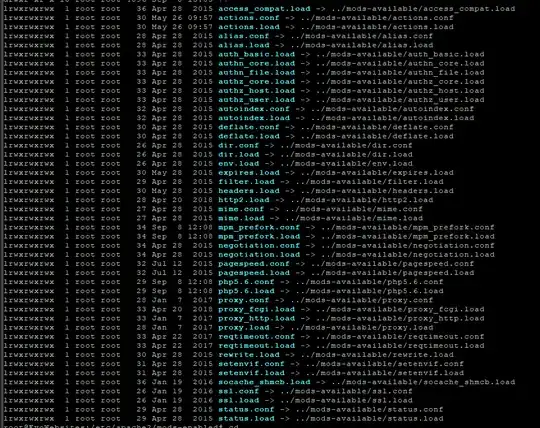

In my case, the error started to appear after doing apt upgrade. After playing a lot I went to following directories to see what I can disable.
  • /etc/apache2/mods-enabled - a2dismod (to turn back on a2enconf)
  • /etc/apache2/conf-enabled - a2disconf (to turn back on a2enconf)
In my case, I had to those MODS enabled.
It seems that apt-upgrade must have removed/broken php7.2 because as soon as I disabled it and restarted everything worked. Of course, in anyone else's case, it may be something different. When Apache crashes it may be bad config or bad mod. You have to pick your battles.
