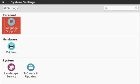

my system setting is messed up:
Please help , how can I get my system settings back ?

When you purge alsa-base pulseaudio with the command:
sudo apt-get remove --purge alsa-base pulseaudio
This remove the following packages:
  alsa-base* indicator-sound* libcanberra-pulse* osspd* osspd-pulseaudio*
  pulseaudio* pulseaudio-module-bluetooth* pulseaudio-module-x11*
  unity-control-center* unity-control-center-signon*
  webaccounts-extension-common* xul-ext-webaccounts*
This leads to this miss up since you remove the unity-control-center* and the unity-control-center-signon* and the other packages listed above.
In order to solve this problem you should install those packages again.
sudo apt-get install alsa-base* indicator-sound* libcanberra-pulse* osspd* osspd-pulseaudio* pulseaudio* pulseaudio-module-bluetooth* pulseaudio-module-x11* unity-control-center* unity-control-center-signon* webaccounts-extension-common* xul-ext-webaccounts*
If this make some problem then it's better to install one package at once.
