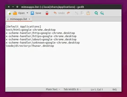

I'm sorry that this is a bit late but I hope it is still helpful to you and others. I've never found the 'exo' method to work either and it was annoying to install an application for just this purpose so I looked for the manual method. The way to properly set this option (for the current local user) is to edit the file
~/.local/share/applications/mimeapps.list
and add this snippet to the bottom
inode/directory=Thunar.desktop
so that it looks like the one I am linking below.

Default applications list
