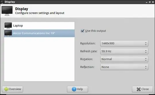

First, open up monitor config - it's in Start > Settings > Settings Manger, then open the Display item.
Make sure both your displays are on. enter image description here

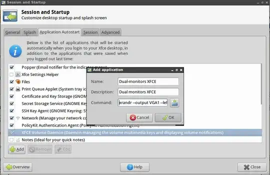

It will disappear after you logout. So, you need to add it to your login items.
Head over to Start > Settings > Settings Manger, then open "Session and Startup", add the above command to your login items, and you're good to go!

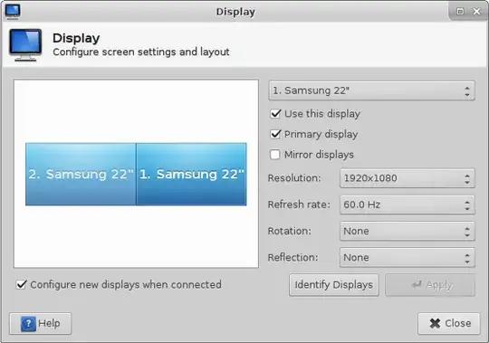

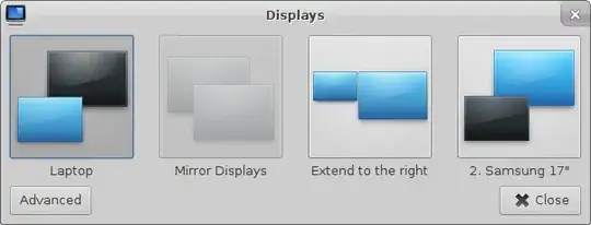

If you have a "monitor switching" button on your keyboard
  1. Plug in external monitor.
  2. Click your monitor switching button, and then in the "Displays" dialog choose what monitor you want to use, or if you want one to extend the other or mirror the other: "Displays" dialog
If you have no "monitor switching" button on your keyboard
  1. In the Whisker menu, find the Setting Manager and click Display (or search for Display in the Whisker menu).
  2. Check "Configure new displays when connected", and close the dialog: Display Settings
  3. Plug in the external monitor
  4. The "Displays" dialog should have popped up automatically, now you can choose what monitor you want to use, or if you want one to extend the other or mirror the other: "Displays" dialog
More information: http://docs.xfce.org/xfce/xfce4-settings/display
