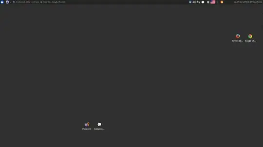

I'm using three display setup and Xubuntu 13.10.
The useful region of desktops are limited. I can't place icons beyond some region in the center of the screen.
Please see the screenshot of my primary display: Primary display desktop
For example I can't move Firefox icon higher than it is now. And I can't move PhpStorm icon lower that it is now.

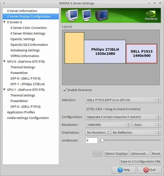

Here's my NVidia configuration: NVidia configuration window
Why is that? How to fix that?
Xfce 4.10 has only limited support for multiple monitors. The upcoming 4.12 is better at that (see design/xfce4-settings/display for details). You can try installing the (unreleased) 4.12 from ppa:xubuntu-dev/xfce-4.12 to see if it fixes your problems.
Additionally, did you try to set up the monitors properly by using arandr? Or perhaps you simply need to follow the advice in this question: How do I setup dual monitors in XFCE?.
