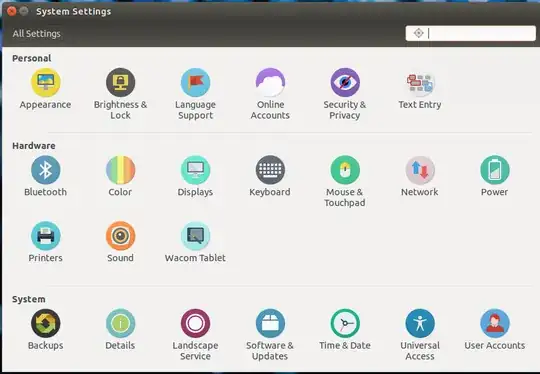

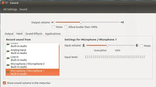

Try this: go on System Settings, then Sound as follow
Now, go to the Input section and select the source device.
Then, start recording from Audacity like you used to.

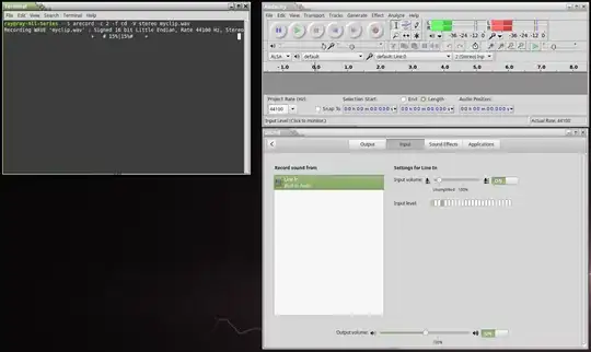

There are lots of posts and tutorials about this subject, and it is fraught with challenges. My project involves copying all my old VHS tapes to DVD. The usual video capture hardware based on the Empia 2861 chipset produces rubbish audio, noisy, distorted and full of glitches and dropouts. The solution is to use the 2861 hardware to record the video, and record the audio via the computer line input. This involves purchasing or making up an adaptor cable from twin RCA connectors to miniature stereo jack.
The application of choice for recording audio appeared to be Audacity. The problem is that on long recordings (over an hour), Audacity has a nasty problem of stopping, locking up or dropping periods of recording. Changing focus appeared to knock it out of record mode, and even when I left the computer alone with only Audacity running, it still dropped out of record mode. When I tried to splice the resulting clips, Audacity just sneered at me and crashed.
Screenshot of recording session
After a lot of research I discovered that arecord is built into our Linux distros. It is a very simple command-line application, which can be persuaded to show a VU meter of sorts. This has proven to be very reliable, and makes nice (huge) WAV files from the line input. The screenshot shows an arecord session in the terminal window at top left. The -c 2 parameter puts arecord into stereo mode. -f cd sets the resolution (16 bits) and the sample rate (44.1 kHz) to the normal PCM standard. -V stereo produces the VU meter on the line after the command. This generates about 10.6 Mbyte per minute. Ctrl+C terminates the recording.
Next thing is to adjust the level on the line signal. Click on the speaker icon in the system tray left of the update status, and select “Sound Settings.” This produces the screen at lower right: select the “Input” tab. This allows you to set the level to give a reasonable fill of the level meter without clipping. Beware: the “Input Volume” slider is very sensitive; but once selected, you can inch it up and down with the left- and right-arrow keys on the keyboard.
Now we can record, but we can't hear what is being recorded. For music videos, I was finding it much better to record the sound track separately and sync it to the video later, so I could not look at the video to see where things had progressed to. This is where Audacity comes into its own. You can see my Audacity session at upper right of the screenshot. The input is selected as “default: Line:0” and the output as “ALSA.” Pull down the “Transport” menu and make sure that “Software Playthrough” is checked. This effectively connects the line input to your speakers. Click the down-arrow next to the microphone icon, and select “Start Monitoring.” Lo and behold, the level meters come to life, and you can hear what is coming into your line input. I find the Audacity level meters a bit more informative than the command-line jobbie attached to arecord. Again, simple things knock Audacity out of monitoring mode, but you can switch monitoring off, then back on, and it carries on working. Audacity's shenanigans do not appear to affect the recording made by arecord.
Don't touch the Sound Settings applet whilst recording. This will introduce snaps, crackles and pops into your recording.

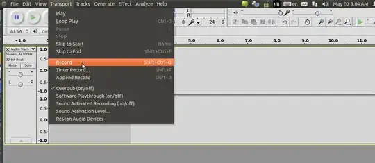

Simply press the shortcut Shift+Ctrl+G or open the menu Transport > Record
This will start recording your streamed audio.
