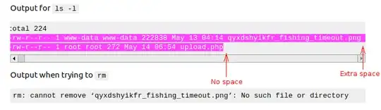

Reposting in detail, expanded from my comment on Eliah's answer
The problem is invisible, but can be seen if you know what to look for: The file name includes a space at the end. Because you copy/pasted the entire ls output, it can be seen in the question if you highlight the output, or edit the post and move the cursor to the end, or (as Eliah pointed out) look at the diff in the edit history. I highlighted the ls output in the post in this screenshot:
Extra space
A quick little terminal session to duplicate the problem, with comments:
$ touch 'foo '        # Create file with a space at the end
$ ls -l               # Space is not visible in ls output
total 0
-rw-rw-r-- 1 izkata izkata 0 May 14 21:59 foo
$ rm foo              # Cannot remove it when not specifying the space
rm: cannot remove ‘foo’: No such file or directory
$ rm 'foo '           # Can remove it if we quote the file name and include the space
$ rm foo\             # Or can escape the space to tell bash to include it as part of the filename
Using tab completion would have also completely sidestepped the problem here, as bash is smart enough to escape spaces correctly (It's also a good habit in general, speeds up typing paths so much).
For example, had I typed rm f<tab>, it would have auto-completed to rm foo\<space><space>, as in the last example in the code block above.
Izkata
