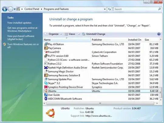

Open the Windows Control Panel. Search for “Wubi”. If it’s there, then you have used Wubi.
Alternatively, check for Wubi in the list of installed programs. It shows up as “Ubuntu”:
Screenshot of Windows “Programs and Features” dialog showing where to find Ubuntu.
