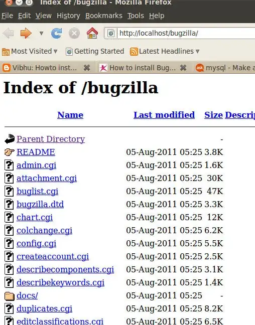

After an isntallation of bugzilla, and after several answers answered Bugzilla is not running - Access forbidden How do I install Bugzilla? How to launch bugzilla after installation?
When I go to the http://localhost/bubzilla I do not get the bugzilla application, but rather a list of files (directory browsing) enter image description here
What am I missing please?

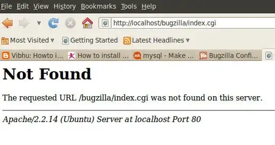

I want to add that for every file trying to click, I get: File Not found error. enter image description here

Basically, you need to tell Apache to associate .cgi extension with Perl. Also, index.cgi should be treated as directory index. Here's Apache documentation (not for faint-hearted)
I would expect the README file I can see on your screenshot contains valuable hints and pointers - have you read it?
UPDATE: You're doing it all wrong. :) See my answer here
