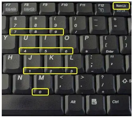

Why numlock is disabled by default?
I think because of some laptops and netbooks keyboards require numlock to be disabled to function all keys.
For example look at this laptop keyboard, When enabled, NumLock lets you use the 7-8-9, u-i-o, j-k-l and m keys as a numeric keypad.
