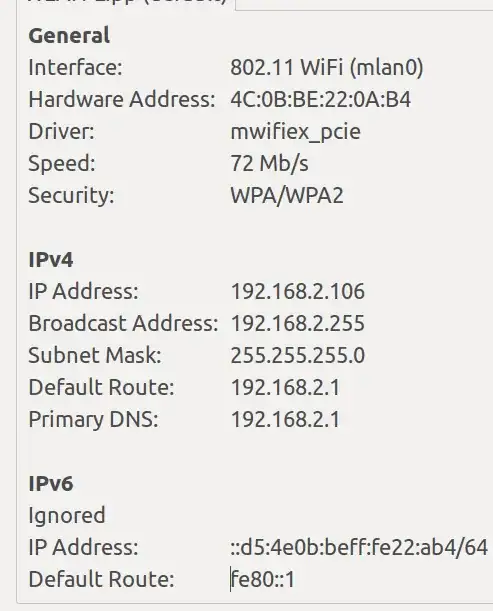

When I run apt-get update on my machine it gets stuck at:
100% [Connecting to security.ubuntu.com (2001:67c:1562::15)] [Connecting to archive.canonical.com (2001:67c:1360:8c01::16)]
I have made no recent changes to the system and use my home network which worked fine previously.
I can't explain why it switched to using IPv6.
I have IPv6 set to ignore for the wireless network:
