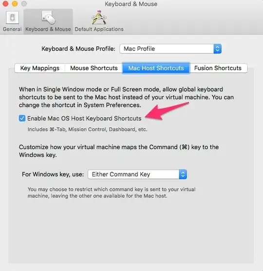

For anybody else using VMware:
  1. Go to "Virtual Machine" -> "Settings" -> "Keyboard & mouse" -> "Edit Profile..." for "Mac Profile" -> "Mac Host Shortcuts" -> Check "Enable Mac OS Host Keyboard Shortcuts"
Picture of the menu screen
Tested using VMWare v7.1.3 and Ubuntu 14.04
