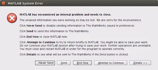

I can't open Matlab 2013a after I upgrade Ubuntu 14.10 to 15.04. I have also tried to open from the location folder, and when I try to open it from the console using $
$ cd /usr/local/MATLAB/R2013a/bin/
$ ./matlab
I get the following message.
