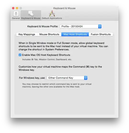

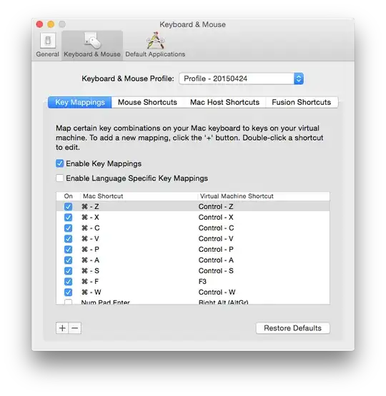

Copy and paste between Mac and Ubuntu using keyboard shortcuts (Command+C then Command+V) worked fine before. I don't know if it is because of the recent upgrade from VMware Fusion 6.x to 7.1.1 or the installation of the VMware Tools patches, but copy and paste does not work any more. Here are some screenshots of the settings:
Could anyone help?
