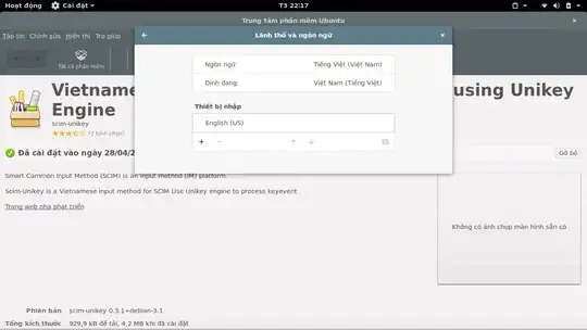

I want to set my input source to ibus-unikey(i installed it and set my input to ibus) but can't find it anywhere in setting.
In 14.10 there are a input source tab in Region and Language but now it isn't.
I opened the language section but there is nothing in it.
Is there any way to open ibus please help me.

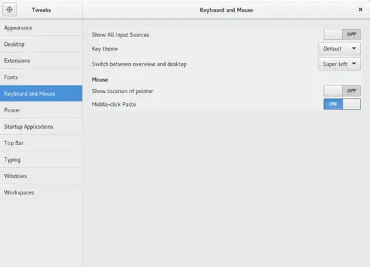

Install the Gnome Tweak Tool:
sudo apt-get install gnome-tweak-tool
Select Keyboard and Mouse and switch Show all input sources on.

After having installed ibus-unikey, you probably need to log out and log in again. Then you should find it if you open Region and Language and click the plus (+) character under Input Sources.
