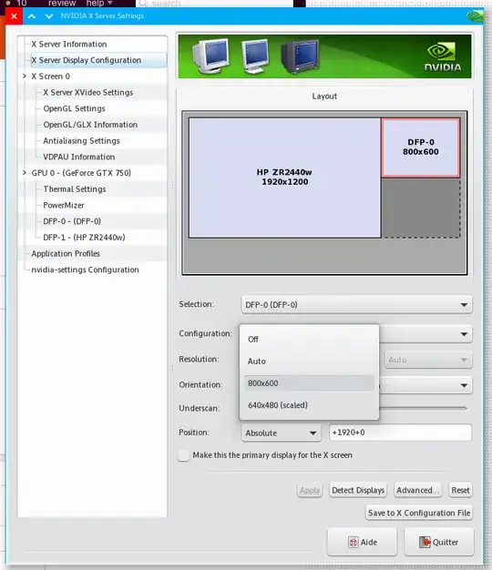

I have installed the last proprietary Nvidia driver installed (346.59) on a GTX 750 card. After the upgrade to 15.04 (Kubuntu) I can't change the resolution of my second screen up to 800x600. 340 driver is the same.
What is the problem ?

The 340.76 version from edgers ppa works:
sudo apt-add-repository ppa:xorg-edgers/ppa
sudo apt-get update
sudo apt-get install nvidia-340
